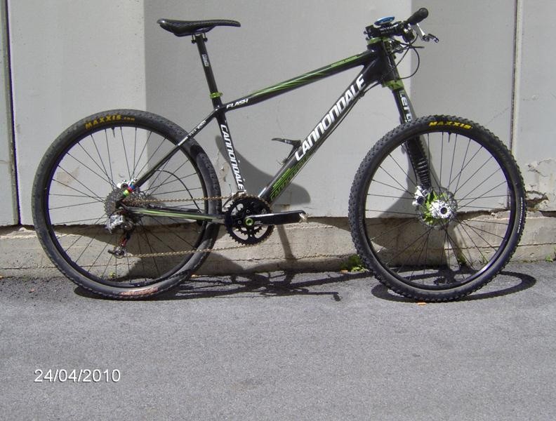

Component Description (Manifacturer Model Size Notes) Weight (g)
Bar Ends: ///// 0
Bottle Cage: Saso Carbon 8
Bottle Cage Bolts: ergal bolts x 2 2
Bottom Bracket: Cannondale BB30 132mm + 2 bearings 6806 2RS 152
Brake Rotors: Scrub Components 160-140 + adapter + bolts 124
Brakes Rear: Formula R1 + 4 green Ti bolts 176
Brakes Front: Formula R1 + 2 green Ti bolts 183
Cables / Housing: Powercordz + Alligator I-link 45
Cassette: Recon Ti 10speed 11-34T 170
Chain: KMC X10 SL 225
Crankset:
- Crank Arms: Cannondale SL Hollowgram 282
- Crank Bolts: Cannondale green 15
- Outer Ring: Zeta Components 41T 100
- Middle Ring: Zeta Components 25T 60
- Spider: //// 0
- Ring Bolts: KCNC black 10
Derailleur Front: Sram XX 42-28 S2 direct mount + 2 bolts 115
Derailleur Rear: Sram XX + AFC white delrin pulleys 160
Fork: Lefty 2010 DLR SL Carbon + Matthias Hellore carbon tube 1250
Frame: Cannondale Flash Carbon M size 950
Grips: Progrips light 20
Handle Bar: Schmolcke TLO 31,8 x 560mm 84
Headset: Cannondale bearings + cover 62
Headset Cap/Bolt: ///// 0
Headset Spacers: ///// 0
Pedals: Egg Beater 5TI 144
Quick Releases: Taiwan green skewer 28
Rear Shock: ///// 0
Seat: AX Lightness Apollo 76
Seat Binder: Cannondale 30mm 16
Seat Post: MCFK unidirectional 27,2 x 350 114
Shifters: Sram XX trigger 190
Stem: Rotor S2 102
Tire Front: Maxxis Minotaur 1,9 378
Tire Rear: Maxxis Maxxislite 1,95 298
Tubes: sealant 146
Wheel Set (Entire):
- Rims: Notubes MMX Podium 290 + 285 + yellow tape + valves 595
- Spokes: Sapim C-Xray 138 + 139 277
- Nipples: ergal x 64 23
- Hub Front: Tune Cannonball white 95
- Hub Rear: Tune Kong supersharf white 212
Misc Option:
Lubricants 53
Total Weight 6940 Grams 15,30 Pounds
